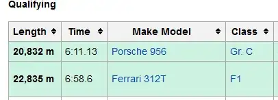

The fastest lap time set at the Nürburgring is 6:11:13, set by Stefan Bellof in 1983. It had 630HP and weighed 850kg.
However, we have lighter, faster cars now. Chassis and wheels are being made with carbon fiber, electronics are better and faster and smaller and lighter, 1200+ HP is possible in racing engines with perfectly tuned sequential fuel injection, and we have 30 additional years of technology, materials science and automobile engineering, and yet the 1983 record still stands and the Pagani Zonda R made headlines when it ran 6:47:5. Over 36 seconds slower, with 32 years of time lapse...
What is going on here? I understand that safety regulations and racing rules may prevent an in-race lap that beats the time, but of all laps, with all cars timed the record still stands.
Why hasn't this record been squashed, and why is it light-years ahead in lap times to everything else?

After all the hand waving and posturing, allow me to point out that the track was a whole 2 kilometers shorter when the 956 set that time. Also, those 2km were a technical part.
Aside from that, one should also take into account the fact that the Porsche 956 weighed only 800kg. That's lighter than a Fiat Uno Mia. No supercar today weighs less than a ton (more like 1200kg). The Pagani Zonda R has a similar peak horsepower and kind of has the same construction as the Porsche 956 (monocoque suspension, center engine, RWD), but it weighs 400kg more. The Zonda weighs half a 956 more, and any racing driver will tell you than even 10kg will make a huge difference.

In short, the Porsche 956 made use of underbody ground-effects which modern-day challengers do not utilize to the same extent.
The 'Ring is a very technical circuit. The lap times are not going to be governed solely on raw power; cornering speed is key. Ground effects gives so much grip that in the words of one '70s F1 driver, you can "paint the road" with it.
While the combined impact of modern-day technology and ground-effects is expected to be better than whatever was technically possible three decades ago, we need to remember that '70s-esque ground effects is outlawed by most, if not all, racing regulations because it is deemed too dangerous (and a little too effective).

In 1983 there was a bypass where the GP track was being built giving a slightly faster circuit when the record was set but more importantly in 1984 Nürburgring grand prix circuit was opened so racing takes place there instead and for safety reasons racing cars, inc F1, etc do not run at full speed on the old track.
Road legal cars are edging ever closer to the record, they will beat it eventually. Don't forget that tyres play a major part in race performance. It is pretty amazing that they can even be so close.
It is not that cars are not faster because of ground effects. Various types of modern track cars could beat the record unmodified if they were allowed to make an attempt. This was shown in 2007 when Nick Heidfeld ran F1 demo laps which were only slower than the record because of slowing down for photo ops. If you take the time for parts of each of the 3 laps without slowing and stitch them together he would have beaten the record by almost a minute.
