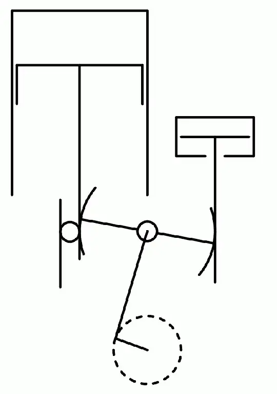

To that end, there is an engine designed by Peugeot, named the MCE-5. Wikipedia described it as:
The Peugeot design works by varying the effective length of the con-rods connecting the piston to the crank. When the con-rod is shorter, the compression ratio is lower and vice versa. On the left hand-side of the diagram is the conventional piston of an internal combustion engine. On the right is an hydraulic cylinder with double-acting piston. This acts through a rod-crank system with a gear wheel, whose movement adjusts the effective con-rod length and thus the compression ratio in the left cylinder.
Mechanically, this design seems like a nightmare. Here is a simple stick drawing of what it looks like:
Image pulled from Wikipedia article.

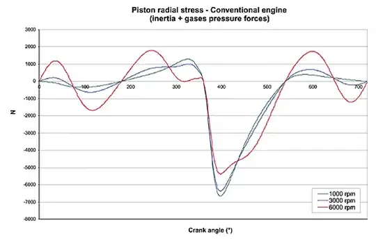

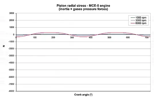

These two charts show the actual differences between the two engine types and the amount of stress which occurs due to the side loading.
I present this really to show that there are other efficiencies with the design of this particular VCR engine. While you may not be creating new horsepower due to the mechanical design, you are freeing up horsepower in the process, which equates to the improved efficiency.
