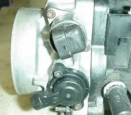

Sounds like the IAC (Idle Air Control) valve/sensor is faulty. The IAC is a small piston that moves in/out and regulates how much air goes through it to control the idle speed. Your issue seems to be that the IAC is getting stuck in the open position (due to wear or it being dirty) and then working again once a full stop happens.
Get some throttle body cleaner and spray it in. If that doesn't fix it the part is pretty cheap. Like $20. You can replace it yourself. Its the one in the bottom. Remove two bolts and replace. That's it.
IAC location
