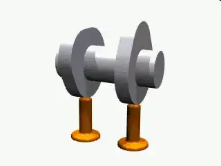

Here's an animation -
This is how a cam controls poppet valves. Read about cam profile here

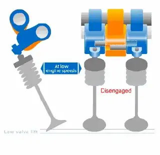

This diagram does a decent job of explaining VTEC:
VTEC Explained
In a nutshell (paraphrasing the Wikipedia article), you have two cam profiles, one designed for low-RPM operation and fuel efficiency, the second (taller cam) for performance. The ECU decides when to select which profile based on several engine parameters by actuating the locking pin that runs through the rocker arms.
