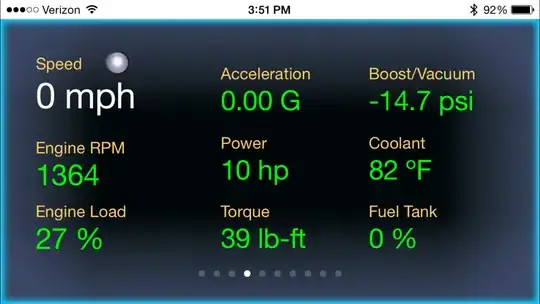

Engine Stats right before shutdown: Engine Stats

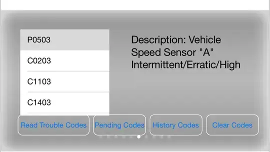

OBD DTC: OBD Trouble Codes
UPDATE #2: So it turns out that my OBD reader was giving me the wrong codes. The real codes were P0351-354, all referring to the ignition coils (which I replaced at the same time). The car starts, registers the fault and then shuts down the injectors. They are the correct coils, and obviously they are getting current because the car starts.. why would it register those codes. I've reseated them checked all the connections. Unfortunately I didnt keep the old coils.
