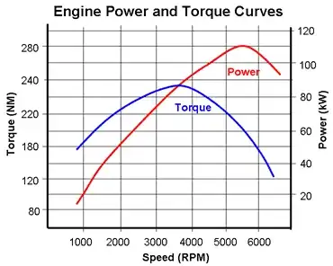

The short answer is no. The engine is most efficient at the RPM when maximum torque is achieved. It's easiest to explain with a picture. Engine Torque and Power VS RPM
Power is a function of torque and RPM. Maximum torque is achieved because the engine is able to move the maximum amount of air and fuel in and out of the engine. The power continues to climb even when the torque starts falling because the RPM is climbing faster than the torque is falling. Eventually the torque begins to fall so fast because at the high speed the engine struggle to move the fuel and air in and out. Finally to torque drops of so drastically that the power also begins to fall.
