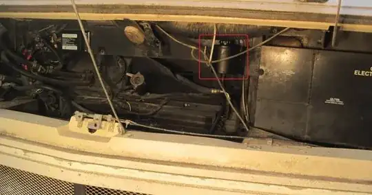

Low-speed steering on this RV causes a loud squeal, presumably a slipping belt. I am trying to find check the level of the power steering fluid. I found this unmarked reservoir in the forward compartment (in front of the engine).
(click for full size)

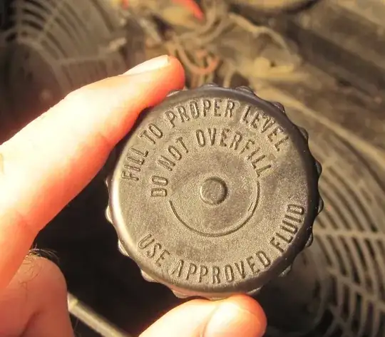

The cap doesn't help much:
I have tried to follow the tube coming out of the bottom of the reservoir, and it looks promising, but I'm not certain (it's difficult to trace). I haven't identified a reservoir for the brakes yet, either, so it could be that.

Yes that is the power steering reservoir.
Yes, it is your PS Fluid reservoir. Brake Fluid Reservoirs do not have the dipstick type of cap you have displayed!
