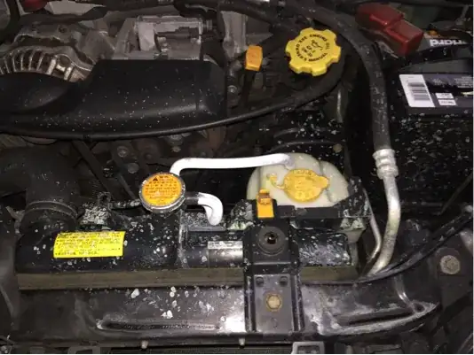

Funnily enough, I am currently experiencing similar issues with my (completely different) car. I smelled coolant, looked under the hood and saw this:
lots of coolant everywhere
Even with new coolant, I noticed that it was boiling out of the overflow pipe.
So, what does this tell me? I'm almost certainly losing pressure somewhere in the system which, due to the ideal gas law, allows the coolant to reach boiling point even though the car isn't overheating.
What should you do? Get the car hot, open the hood and then listen carefully in various places over the engine (obviously it's hot, so watch out under there).
My suspicion is that you'll hear exactly what I do: hissing right at the radiator cap. The solution is pretty simple:
  1. Buy the replacement cap for about $20 USD.
  2. Wait for the car to cool off.
  3. Replace old cap with new.
  4. Top off coolant.
  5. Drive around enough to get it hot.
  6. Confirm no boiling and no hissing.
  7. Go to the shop and have them flush the coolant. Tap water is not good for the cooling system. You should always use a proper mixture (and Home Depot Prestone is probably fine).
  8. Come back here and brag about how you fixed it. :-)
