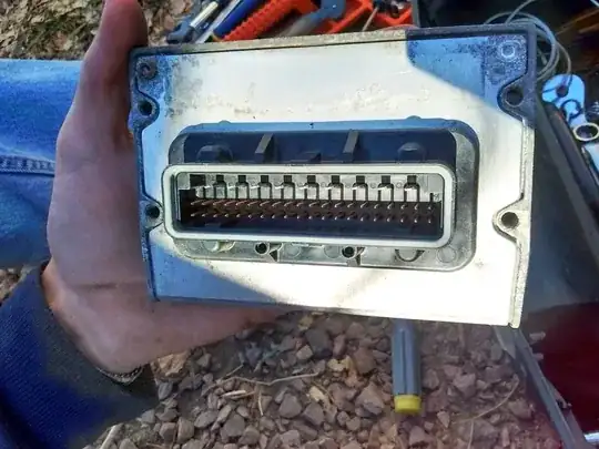

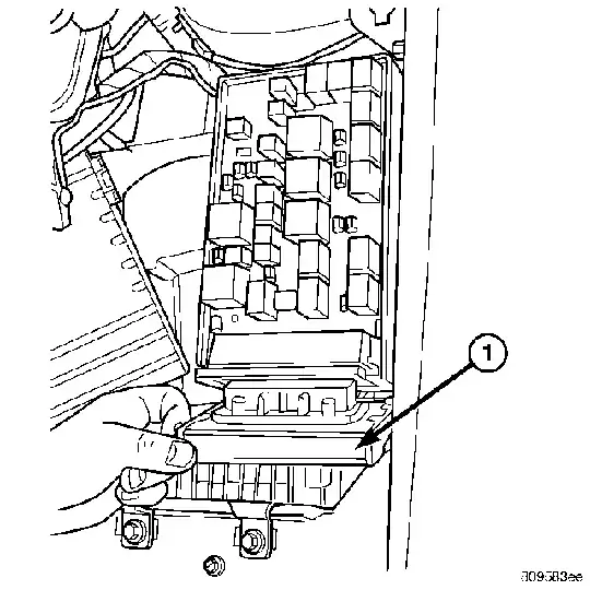

  1. Take off the FCM (Front Control Module) This is the metal box directly in front of the fuse center, next to the battery. You'll have to take off the cover of the fuse box. The FCM is held in by four torx screws. FCM
  2. Clean the flat metal terminals by sanding them. Flat Metal Terminals
  3. Give them each a slight twist, to force a better connection. Give each metal terminal a slight twist
  4. Put the FCM back in. You're done!

Did this and it still didn't work. BUT then I tried rotating the IPM and cleaning all the contacts on C1 (green) and C6 ("yellow") connectors seemed to do the trick. Not sure which one did it, but they're now both on! Thanks!
