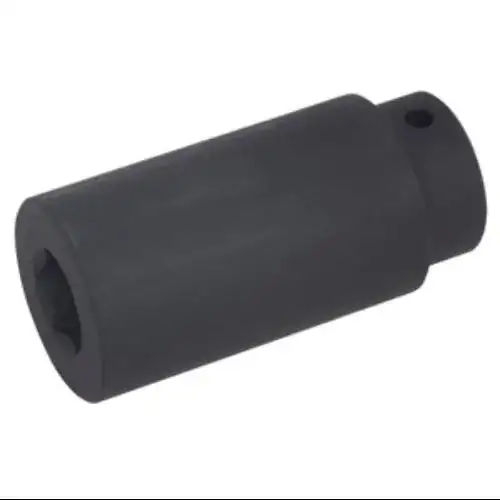

Something which has not been mentioned in the other two posts about impact sockets is the mass. While the material used for impact sockets is more robust and will stand up to a lot more abuse, the real reason there is more material in the socket is for mass. The impact gun throws the mass of the socket ahead for a brief second. The more mass the socket has, the more of an impact it will make against the fastener. This has to do with physics and Newton's second law of motion:
The acceleration of an object as produced by a net force is directly proportional to the magnitude of the net force, in the same direction as the net force, and inversely proportional to the mass of the object.
In other words: More mass = Greater impact
This bears out in the following impact socket, which is used for taking the harmonic balancer bolt out of the Honda engines:
You'll notice the wall design is about 3x the thickness of most impact sockets. This isn't because it needs to be stronger, but because of the added mass involved in the overall construction. Trying to use a regular impact on the bolt can work, but not all the time. Using this socket on them works every time. Without something like this, you are relegated to using a breaker bar with a long cheater pipe, then blocking the engine so it won't move. If only one person is involved, this is quite a chore. It's all due to the mass of the socket, not because it needs to be stronger or some other reason.
