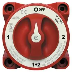

This is actually a feature of most manual leisure battery control switches. They give you a bypass option to start the engine off all available batteries. As has already been mentioned, it's not something you should be doing on a regular basis but it's considered a reasonable thing to do.
leisure battery isolator switch
