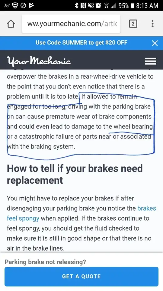

Vyt is right. This happened to my Subaru xv; had to change hubs at 65,000 miles because my mother drove my car with the parking break on for 30 miles. Heat can change properties of grease. There's evidence online. I'm also a chemistry teacher. I will, however, agree that it does depend on the setup of the car and its parking brake system.

You have to check wheel bearings. They and wheel grease were overheated and you drove with this for a while, so at least you may need to check and change wheel grease.
