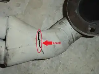

Most likely it is not more serious than that but sometimes if your exhaust manifold has a hole or crack in it or you have a hole in your exhaust pipe upstream from the O2 sensor then this can also cause it to run too rich as the sensors report too much air and not enough fuel in the exhaust. You should be able to hear this as well as see the breach. Inspect your pipe.
Cracked Manifold
