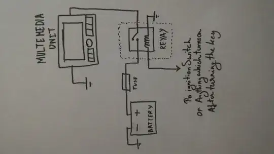

It seems very odd that your system drags so much of power . I would not recommend to directly connect to the ignition switch. Instead you can attach a relay in the following manner: (apologies in advance for poor drawing )circuit
