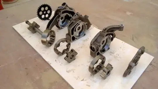

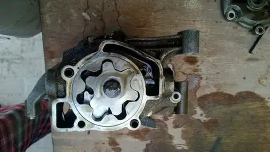

Here are a couple of pictures that show the inside of my oil pump. The "exploded" view shows how the pump pressurizes the oil in three stages. The three gear-shaped rotors mount on the shaft at the back and act in conjunction with the ring-shaped idlers.
Top View
Oil Pump - Exploded View
