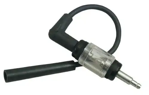

Due to my recent problem with weakly firing plugs, I'm looking at inline spark testers. I've seen three basic types:
The simple flashing one which goes in between the wire and plug with the plug in place:

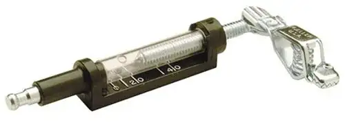

And a type that has an adjustable gap and is grounded:

The first device just tests if current is flowing out of the cable into the spark plug. So if you can see it flashing, coil and cable are fine, but it's still possible there's failure #1.

The third is used without plug and allows to measure the strength of the HV pulse. It should be strong enough to generate a spark up to a certain gap width. For example, 30kV could form a spark over a 1cm gap in dry air. So this device allows to test #5.
Note that none of these tests #1, but a plug can be easily replaced for testing. If the resistance between terminal an thread/frame measured by a multimeter and it's not infinite, then the spark plug is probably clogged with carbon.

The third device allows to measure the pulse strength by testing what's the maximum width of a gap which will still generate sparks. However, if this pipe is filled with ambient air, the width heavily depends on humidity. So, using this is more an estimation than a real measurement. Yet, you may compare all the coils of the vehicle to test if one is weak.
