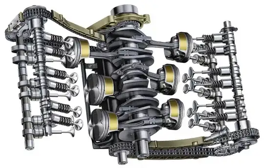

This diagram shows the orientations of the relevant pieces although this diagram is a slightly later version of my engine (mine has 5 chains; this one has 3). The intermediate shaft is below the crank shaft and the intermediate shaft bearing is not quite visible in this picture. However it's easy to visualize where it is -- it's at the far end (top of picture) of the intermediate shaft, just below the main crankshaft bearing. Porsche engine diagram
