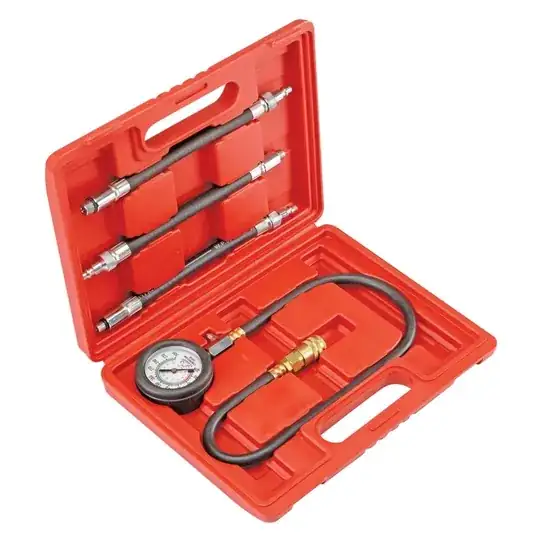

Troubleshoot You can test the compression of your engine with a compression tester.
image of compression test kit enter image description here
You will need to lookup or ask a shop the compression in PSI that your engine requires. I would guess anywhere from 140psi to 170psi.
If your engine is below the number in psi the manufacturer recomends then you will need to follow the advice from @Paulster2 in the other post and redo the top end of your motorcycle by procuring an overbore piston and rings and getting the cylinder rebored to correct size for the new piston and rings.
