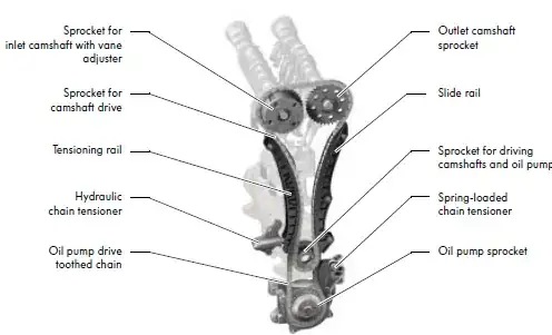

One possible cause might be the 16-year old, slightly mechanically stretched timing chain that gets the "right" amount of additional elongation from the warm engine that puts the engine timing and more specifically the ignition timing out.
Another component that could lead to problems with the timing chain is a faulty tensioner.
