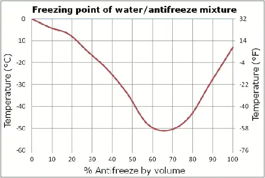

OK, I had some fun... Seriously, here a typical diagram of the freezing point of an water-antifreeze mixture. It clearly shows that the best effect is achieved at about 60% antifreeze in water:
Corrosion inhibitor
You could think that 25% antifreeze would be fine for your climate conditions. But antifreeze also inhibits corrosion inside your motor. Therefore, you need at least 50%.

Finally, most points say that more water is better, but the corrosion part dictates that you should at least have 50% antifreeze, though you don't need the deep freezing point.
Too much coolant also has some adverse effects, so you shouldn't use pure antifreeze, too.
Stay with 50%, it's also cheaper.
