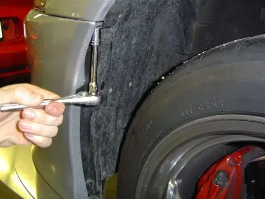

Your rubber is grinding against the front wheel well liner - there is a plastic area there your tire grinds against on full lock because you upsized your wheels.
Solution - take a heat gun and warm up the area where the tire grinds, then push it out a bit. Don't overheat as it easily melts.
Here: enter image description here
