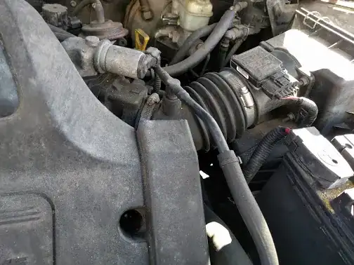

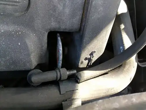

Anyway, as I was reluctantly deciding on how to get the intake manifold off, I noticed this:
Disconnected hose enter image description here
My buddy says it's the crankcase ventilation hose. I decided to stick it back on, get a zip tie to tighten it as best I can, and see if that helps.
I guess my question here is: Does that seem like it could be the source of the problem? And if the symptoms don't show up again, should it be reasonable to think it's fixed? (I mean, overlooking the fact that it's over 100k and could use a tune up anyway.)

Yes, the air that is passed through the crankcase ventilation system is metered before it enters the ventilation system. If the pipe is off, un-metered air will be allowed in, which will cause a weak mixture and therefore possible misfiring.
