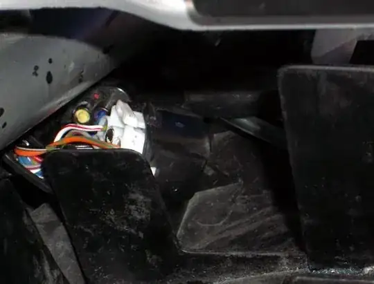

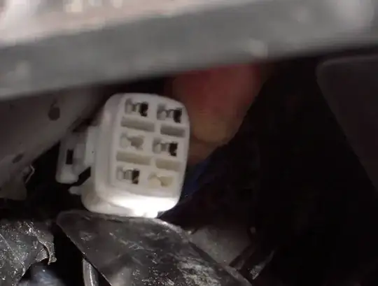

Beneath your rear seat you will see a white connector with a rubber cover over it. There are 4 total connections and two blanks on the connector.
Here's the best pic I could find of the connector

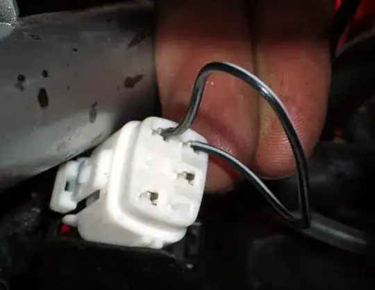

Once you have located it you will put a wire loop between two of the connections with a bit of wire. You will connect two of the 4 active connections in the connector. The two that you want are side by side.
You are going to loop them together with a piece of wire.
Here is the connector wit the wire loop inserted into the two 'active' side by side connections within the white connector.

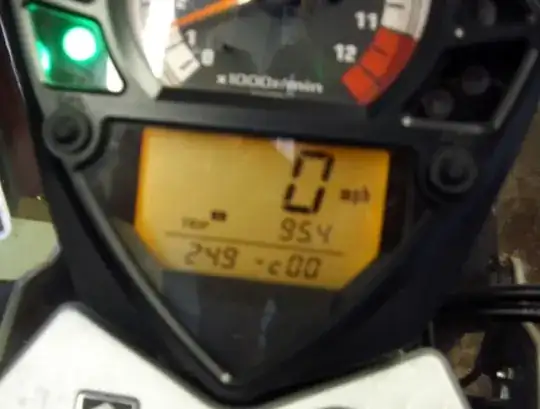

Now, you can turn on your ignition. Look at your dash and see if you have any codes that reveal themselves.
If you get a code c00, there are no codes.
You will see the codes in the bottom right hand corner of your display.

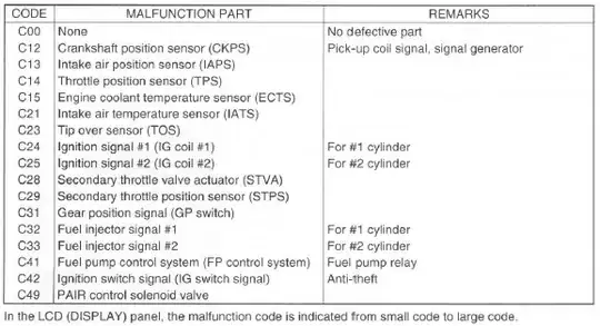

Here is the chart to identify what the codes mean.
There is a code for a TOS.

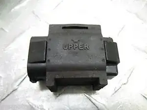

Correction from my comments Your model year does have a tip over sensor
This is what it looks like. It's on the front of your battery. Facing the front of your motorcycle. Ensure it's rubber slot is mounted properly to the front of your battery holder where there is a tab.
Apologies for my misinformed comment, I believed the TOS didn't arrive until 2005. Notice the up arrow stamped into it
