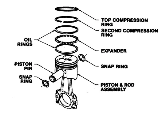

There are several rings on a piston. Depending on the application and use of the piston it may have up to five ring grooves near the crown. Here are some points of interest.
  • The top ring is always the compression ring. It does prevent some oil from getting involved in the combustion process but it is not it's primary duty. The compression rings primary objective is to prevent exhaust gasses from slipping by the rings and getting into the crankcase.
  • The second ring is usually also a compression ring.
This Ring Scavenges Oil

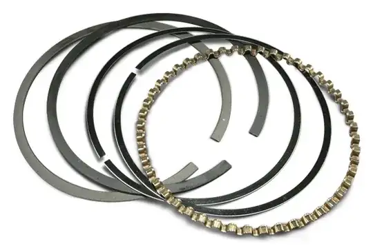

  • The bottom ring is always the oil scavenging ring. In it's groove cut around the circumference of the piston will be two rings separated by an oil control spacer and sometimes called simply an expander or expander ring.
Between the two oil scavenging rings and behind the expander there are small holes drilled into the ring groove. Oil that builds up between the two oil scavenge rings will get back into the crankcase via these small holes.
To Answer Your Question
What prevents engine oil from mixing with petrol in motor bikes?
Oil Scavenging Rings
The uneven brass colored ring is the expander. It prevents the two oil scavenging rings from touching in the ring landing and allows oil to buildup and pass through the holes in the piston that give access to the crankcase.
