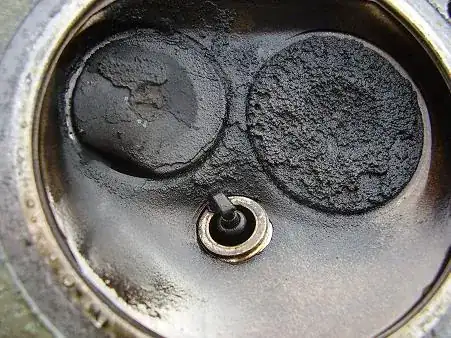

....and that's how it really happened. The guy with the burned valves jetted his carburetor incorrectly and set his float level too low. He didn't set his timing correctly either and had a late spark right at TDC, not before. The lean condition combined with a late spark left some of the lean over oxygenated intake charge still burning when his exhaust valves began to crack open. The still slightly burning superheated exhaust gasses from too much oxygen in the AFR from incorrect carburetor settings slowly overheated his valves and they deteriorated over time until they began to even crack a bit. At that point the performance drop off was noticeable enough where dude began to look into it. After months of troubleshooting he finally tore the heads off and discovered burned valves and gave attribution to the short pipes rather than his lean mixture and retarded timing.
Dudes valve. Bummer dude :-(
