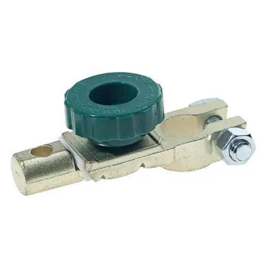

The fastest, cheapest and easiest solution is to add a battery disconnect switch to the car. After placing the ignition switch into acc mode the open the hood and disconnect the switch. When you arrive at your destination, open the hood and reconnect the switch. This costs under $20. It also eliminates the need to run anything or calculate anything. Many auto parts stores carry this in stock.
PS put this on the negative battery cable not the positive.

I found this online.... Should solve your issue:
