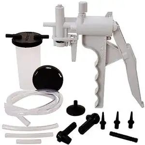

What is the tool used to create the vacuum?
Is it like a might-vac or something?

Using a hand vacuum pump with a reservoir you fill the system and apply ~20inHg. Repeat until you stop seeing fluid entering the reservoir. Leave the vacuum on the system and walk away for 5 or so minutes. If pressure doesn't drop you're good.
