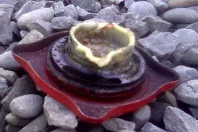

Strange - engine coolant is antifreeze diluted with water. So the seller is claiming he had oil but not water? I would not buy that car.
For the seller, a coolant system flush would in order, both forwards and reverse, and then refill with antifreeze and clean water. If engine oil still appears in the coolant water then the oil is moving from the oil galleries to the water galleries. Check the oil filler cap for white creamy emulsion like this
This would be water going the other way, into the oil lubrication system.
If this is the case, engine oil in the water is evidence of existing motor damage.
