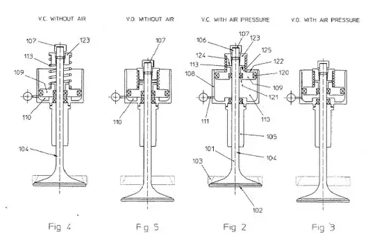

That's why pneumatic valve "springs" have no springs.
Instead, they use a chamber of pressurized nitrogen to return the valves back into the "closed" position after the cams have run their course.
The diagram below (from this webpage) shows a comparison of regular valve springs on the left to the pneumatic setup on the right. The pressurized chamber is marked on the third diagram as "121".

    The cams are nothing special; they operate the valve using a bucket-shim or cam-follower design, so the valves would move down just like it would in a road-going passenger vehicle.
  • Valve Closing
    In lieu of springs, the valves are pushed into their closed position using nothing but high gas pressure.
    The webpage also mentions that when F1 engines with pneumatic valvetrains are pulled out of the engine, a remote gas cylinder needs to be connected to prevent the valves from clattering into the pistons.
