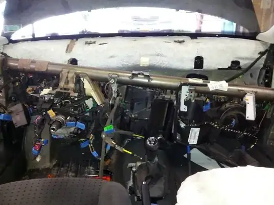

After trying my best not to I decided to replace the core. I used a very helpful VWVortex guide along with a Chilton's manual. 14 hours later I've got air that measures significantly hotter than before, so now it's time to wait and see how things go this winter. I found that I don't have a split HVAC box even though I don't have the Climatronic system (major letdown) and that the flappy bits inside the box were in great shape and moved freely. The old heater core was definitely clogged; simply trying to blow air through it was difficult. For your enjoyment here's what the car looked like when I was finally able to remove the core:
2000 VW Golf dash guts
