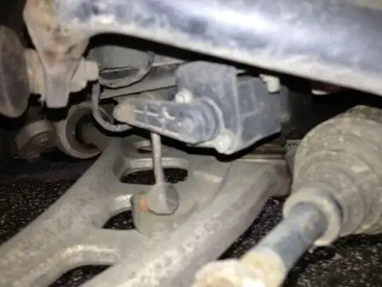

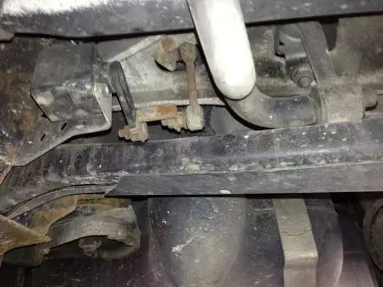

Kaseys answer sounds right to me. There is a sensor, that indicates the vehicles inclination relative to the road (I don't know how to call it either, in Germany we simply call it "headlight leveling sensor"). That sensor needs to be replaced probably. I'd just like to add two pictures, so you can see how the sensor looks like:
E46 front axle sensor
Image source: e46-forum.de
