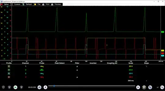

Red = CKP Signal
Blue = ICM 1/4 Trigger
Green = Coil Pack Primary
Yellow = CMP Signal
Pictures
Looks OK for a minute.

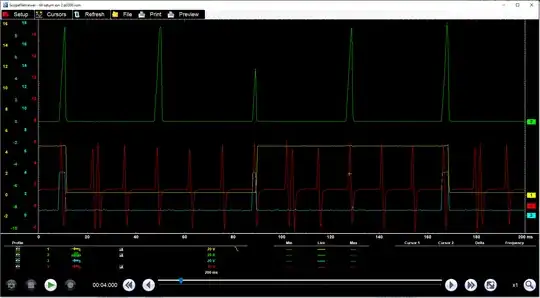

But... Why is that coil suddenly drawing fewer amps?
If you compare the ICM signal delta it's a few milliseconds shorter ~5ms compared to ~3ms.

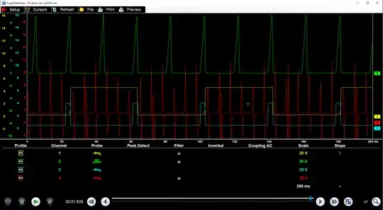

In this one the deltas is down to 2ms
