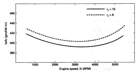

Now, remember the least resonance rpm? Remember how coming closer and closer to that rpm, reduces frictional loses? This is around half way through your rev range. Hence you will get the best fuel efficiency when you are in the proximity of least resonance but low enough to take advantage of points 1 and 2. For easier understanding, look at this graph: This curve denotes the fuel consumption at different engine speeds
The above graph is for an engine on a test bed. For an engine on a car, the lowest point is a little to the left at around 2500 rpm (just like you stated).
