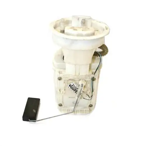

Usually the level is measured by a floater connected to a potentiometer - it's quite likely that the panel is reading an analog voltage signal coming from the fuel sender unit. You could splice into it, the wire shouldn't be hard to find, it would be coming from the rear of the car (the sender unit is often screwed into the tank). Then you could simply measure the voltage (probably 0-12V depending on the fuel level).
Fuel sender pulled out from the tank. Note the potentiometer on the side
Another possibility is that the signal will be PWM, but I've never personally seen the fuel level transmitted this way. In that case you'll need a microcontroller or low pass filter to read it.
