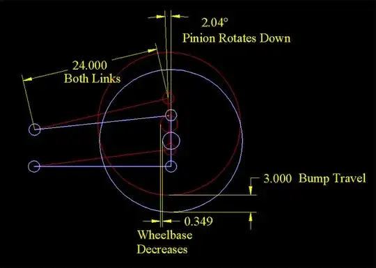

The problem is with unequal length arms (assuming a 4-link suspension as we were discussing in chat), the pinion angle is going to change as it travels through its arc of motion. You can see it in this graphic what I'm talking about.
Due to this you are not going to be able to set it for every ride height. Since your application is not for racing, you want the difference between the drive train angle (engine/tranny line) and the pinion angle to be zero. Since you cannot readily set the drive train angle, it's left up to you to set the pinion angle.
Even if your links are equal length, the pinion angle is going to change.
While 2.09° is not a huge amount, you can probably tell from the image that the longer the links, the less the change is going to be in both pinion angle and in wheelbase.
