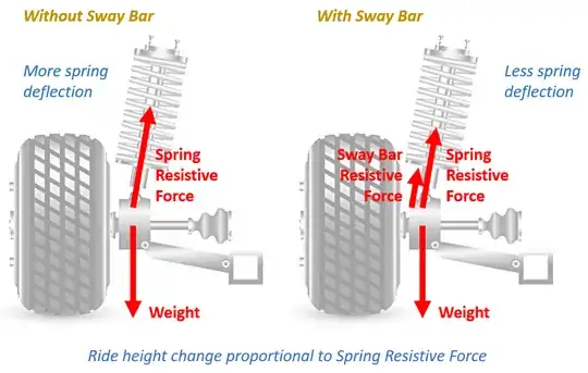

I just read a really nice write-up on sway bar physics. I also watched a video discussing suspension behavior on rough roads.

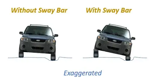

For example, consider the scenario above, cornering left at speed, then in the turn I hit a fairly large, say 2-3cm deep pot hole with the front left wheel.
From my limited understanding the effect of a sway bar that was too stiff would be one of the following, either:
- The left strut would expand into the pothole, exerting downward force on the wheel.
- Via the sway bar, some of this would also be transferred to the right side, exerting an upward force on the right side of the body.
- On exiting the pothole, then, something... complicated would happen that I can't figure out.
Or:
- The left strut would want to expand into the pothole.
- The left side expansion would be limited via the swaybar by the downward force present on the right side due to the turn.
- The left wheel would then take longer to regain contact with the ground, causing the right wheel to experience more lateral force (that was no longer being absorbed by the left wheel), and the car would more readily understeer. And maybe some other complicated thing would happen.
