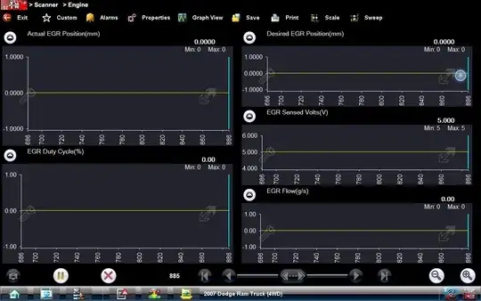

Happend to run into a truck with an electronic EGR setting a position code. enter image description here

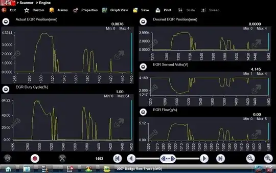

Working enter image description here
