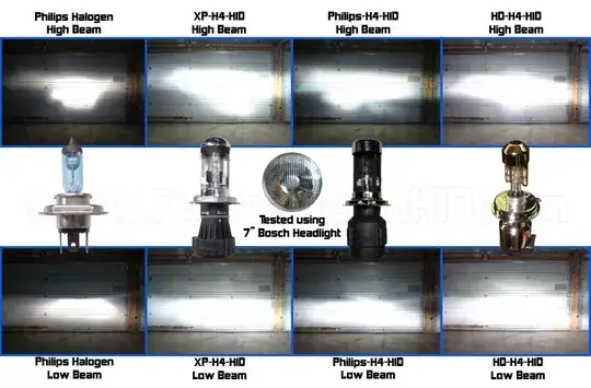

I left a picture from the net just for some visual comparison between beam of different lights. Another I had in the answer I deleted as it seemed to me just a marketing doctored image, like a lot of the images I considered, others would have been a pain to add here. What I was looking for was an actual controlled test of a few different bulbs with proper measurements, maybe from an automotive magazine, but up to now I have not found it. The closest I found is this http://www.which.co.uk/cars/driving/sat-navs-and-car-accessories/best-car-headlight-bulbs/ but while they mention how the test was performed it appears they publish the results but not the measurements proper which would be the actual useful part.
enter image description here Before deciding to go with a brighter bulb one should first check that the light beam is projected where is useful and that the existing bulb isn't old and tired and that the headlight glass isn't all oxidized and fogged up. So users reviews often are a bit of a hit and miss as indication if you don't know how they were driving before.
Personally I always have the impression that with the brighter bulbs I can see less of whats outside the light beam and I don't like them. Others I know instead have as much light as a spaceship in front of them and would still go brighter if they could.
