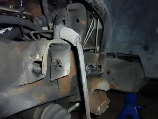

On the upper control arms are two eccentric bolts for adjusting caster and camber.
In this image the knockouts for camber/caster adjustment haven't been removed.

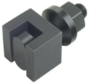

And would need to be either cut out or use a special tool made by OTC.

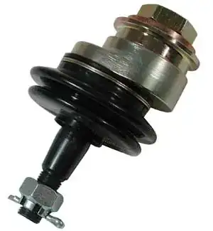

If the camber on the bolts are maxed you can use offset balljoints.
