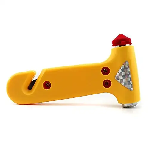

Get an emergency escape tool
For being proactive, the best option is a emergency glass breaking device with a seatbelt cutter like this model:
(Click image to enlarge)
IMG: seatbelt cutter
The Mythbusters have done two episodes on escaping a vehicle in water, and in the second episode, one of the camera men had to have his belt cut off him because he became suck when the car flipped and was not able to release the belt.
The emergency hammer should be secured in a location that you can reach while the seatbelt is tight. Also note that the hammer can't be used on the windshield. Only the side windows and possibly the rear window will break. If your windows are tinted it might make getting through the broken window harder.
