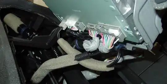

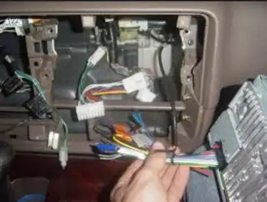

  • Remove the dash and test at the harness (picture below of a headunit disconnected from a dash). Also, when the headunit is removed look for any burns or if the headunit has a blown fuse. If the back of the headunit has a burn mark it can indicate that you have a short or open wire.
  • Make sure it has a well rounded connection with no cuts, kinks, pinches. If you have any open wires it can effect the headunit coming on or short something out.

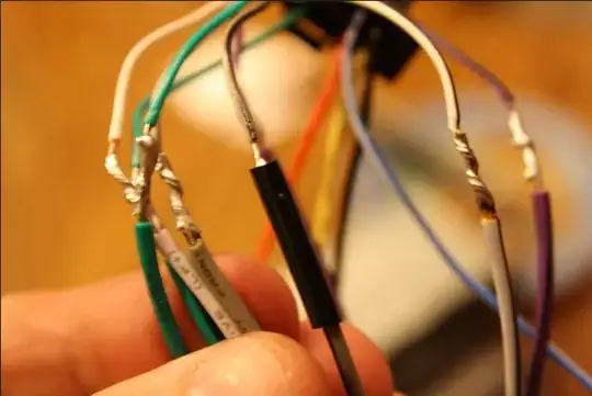

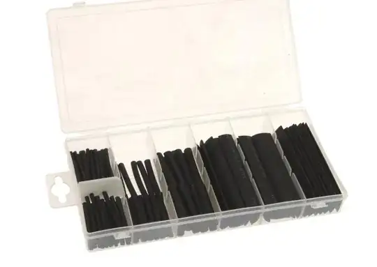

  • The aftermarket wire harness and your aftermarket vehicle harness does better if it's soldiered and not crimped connections. enter image description here If you have crimped connections I would go to radio shack and get head shrink tubing and redo the harness: enter image description here Example item on amazon for the extreme enthusiast.

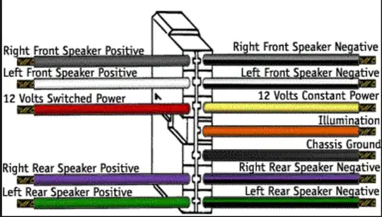

Wire harness colors per Crutchfield:
