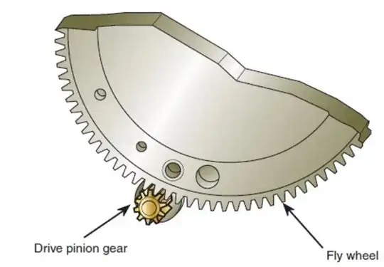

I was under the impression the purpose of the flywheel was to assist the starter pinion gear to start your motor:
So every time you turn your vehicle the starter motor would rotate the gear which would rotate the engine.
