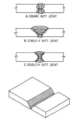

You have a couple of options:
  • Open butt joint
  • Butt joint with backing
  • Lap Joint
  • Offset joint
Open Butt Joint
Source
I would not recommend this for joining frame rails, even though some manufactures (Toyota for example) recommend this type joint for sectioning procedures.

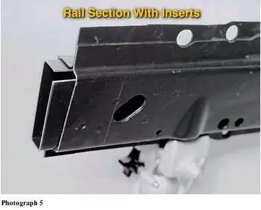

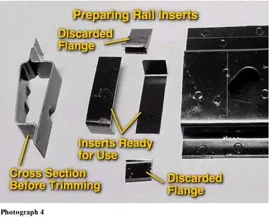

Butt joint with a backing
Can be made from a piece of one of the frame rails, or other scrap metal.
Source
This type of joint will add some strength to the weld and is a little more forgiving to less experience welders

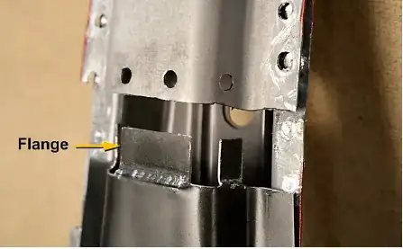

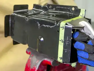

Lap Joint
A flanged lap joint uses one piece to great a flange for the other to be slid over and welded.
Tapered lap joint
You cut the corners out on the end of the rail, bend the flange down giving you a backing to weld too.
