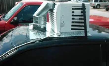

You could always do it with a window air conditioner and a huge inverter, but the efficiency would be pretty bad I bet. The aerodynamics in the below example are also a bit dubious. In a pickup it might actually make sense=- put it in the bed- since a cheap Chinese window A/C is almost free.
