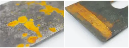

Surface rust may just be that, surface rust. Flash rusting does not necessarily mean that the metal is rotten right through.
Here is an example of flash rust. Most of the time, you can hit this with a wire wheel or flap disc and you will still have structural integrity.

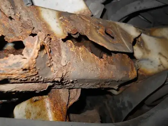

Here is an example of a frame rail with severe rust issues. In the event of purchasing a vehicle with significant damage such as below, you would have to replace the rail completely with new metal.

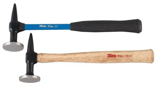

How can you test areas? Bring a magnet and a body hammer. A magnet will let you know how strong the metal is, and if there is any there. It's also a great way to tell if a car has body fill in it.
Use the narrow end of the body hammer to tap areas in question. You will immediately be able to tell the difference between healthy metal and garbage.
