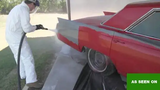

"Dustless", Water Based Blasting
This type of blasting can also be called slurry blasting. The unit holds water, your abrasive of choice, (preferably glass), and a rust inhibitor. You can thoroughly clean any surface, and not have to worry about the metal warping, or rusting. The water cools the metal, and the rust inhibitor will prevent it from flash rusting.

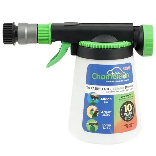

When you are done, you then spray down the vehicle with an attachment such as the Chameleon. The rust inhibitor is inside the canister to prevent flash rusting while you rinse the abrasive off the panel. You can then dry it with a leaf blower.
After all that work, you are ready to paint immediately if there is no welding/bodywork to be done. The cleaning process is done within the blast. This is the only method which is endorsed by the major paint companies like Sherwin Williams and PPG.
