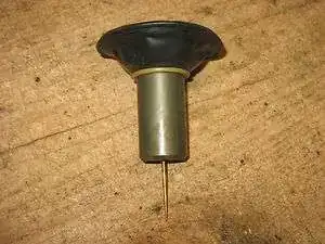

here is an image of a slide, jet needle and diaphragm
Inspect the Diaphragm
Pull on it a bit, put your finger behind an area and stretch it across you other finger and look for holes and cracks. Also, ensure that when you put it in the carb you put the ring around the outer edge back in it's groove properly in the top of the carb body. It's very easy to pinch it and damage in when you put the tops back on it. You will want to press the cover on and feel that the diaphragm is proper inside the carb body groove before you screw it down.
