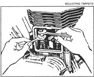

You can adjust your valve lash
You have nothing to worry about. Adjusting valve lash is a standard maintenance item and should be done upon any maintenance or tune up's of your vehicle.
As you can see in the image, getting to the adjustment is quite simple.
From there, follow your factory manual regarding reducing the amount of valve lash clearance.
Your motorcycle will be and is fine. The sounds are normal and can be reduced.
