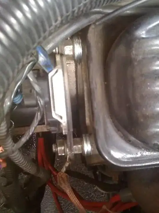

Just because you've replaced the ICM, does not mean it isn't at fault. Usually the way the engine dies with an ICM fault is it ... well ... just dies. The ICM, since it sits directly on the head (in stock fashion) absorbs more heat than the little cooling fins can dissipate. The easiest way to cure this is to do the ICM Mod. This entails getting the ICM off of the head. There are two ways I've done this in the past, that being using three 3/8" flat washers under the bolt/stud. This raises it off of the head and allows it to cool better. I've also found the small spacers which are used on the exhaust are perfect for this. The spacers are found on stock exhaust manifold bolts. Usually, if you put headers on there, these will not be used. Since I personally keep everything (car related - you just never know when you'll be able to use stuff), I had a few I found in the parts bin. If you haven't done this mod, I would highly recommend it even if it isn't the issue. It's very easy to do and will save you money/headaches down the road.
EDIT: Here is a pic of how the ICM mod is commonly approached. Normally, the ICM goes behind the studs against the head:
