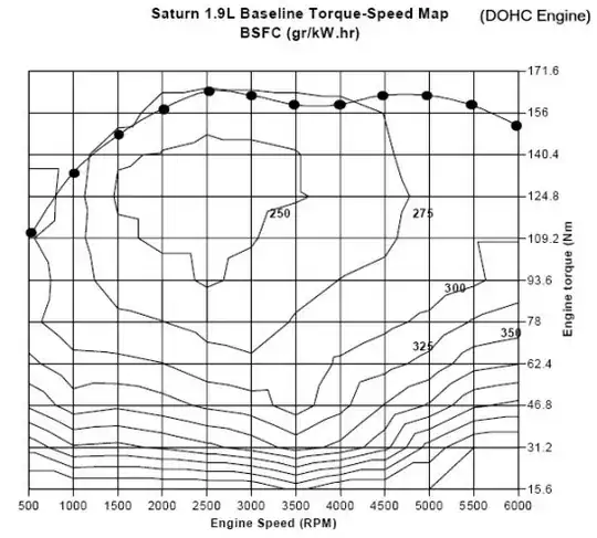

The graph below displays the Brake Specific Fuel Consumption (BSFC - brake specific meaning the engine was mounted on a certain style of engine dyno, rather than in a car). The fuel consumption is measured in grams per kilowatt-hour (1 KWH = 1.34 horsepower). The maximum torque vs RPM (engine Revolutions Per Minute) is displayed at the top of the graph (black line w/ black dots). As you can see, least amount of fuel per KWH is used when THIS engine is running at 2-3k RPM, and outputting 80% of max torque.
Again, when cruising, you only need a fraction of your total horsepower. The engine rpm for most cars in top gear at highway speeds is usually 2500-3500 RPM, so even as your torque requirement goes down and you fall out of the optimum fuel efficiency range, when the value of the denominator (power needed to cruise at 60) decreases, as does the numerator (amount of fuel used).

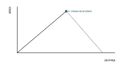

Another, which I will focus on, is that regardless of what speed you travel at, every time you brake, you waste energy. Here's what it looks like if you accelerate and then take your foot off the accelerator:
Coasting

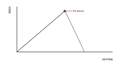

Here's what it looks like if you hit the brakes:
Braking

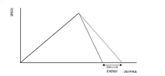

And a comparison:
Comparison between coasting and braking
Thus any time you brake, you haven't gone as far as you could've - you've spent fuel up front in accelerating that could've taken you further. You now have to spend energy again to cover that distance.

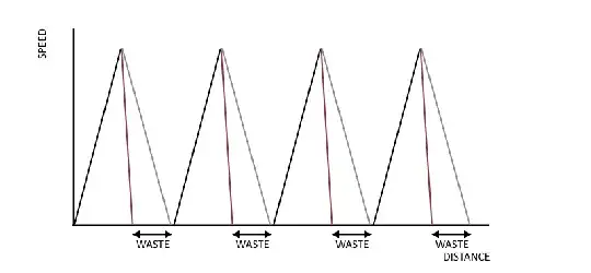

Here's what that looks like in traffic - notice the accumulation of wasted energy:
Multiple braking

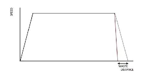

Verses the waste if you just brake once at the end:
Brake once
